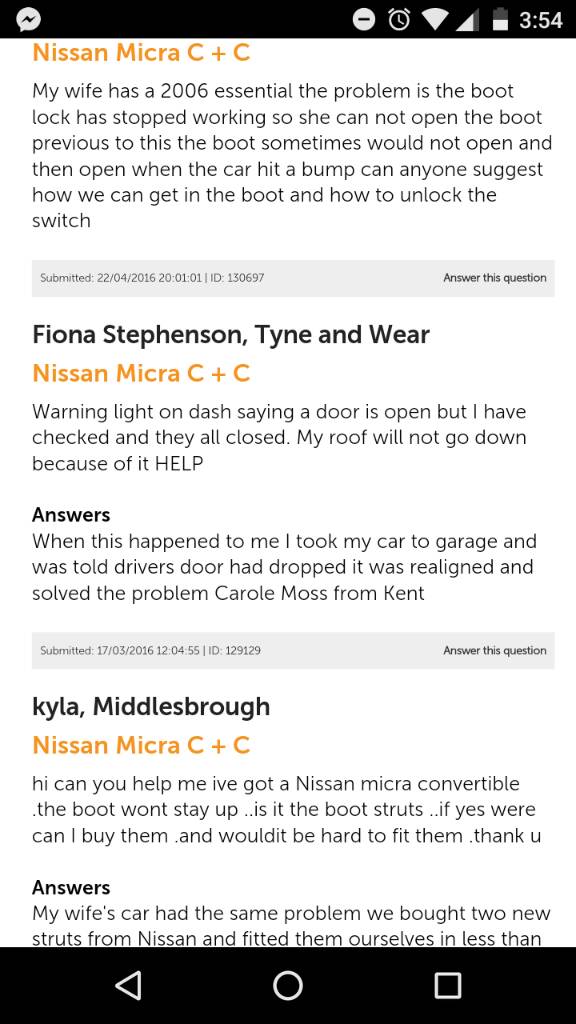

It's sounding the likely culprit. Remove the boot lining by carefully unpopping it,remove the plug off the switch,or have a small piece of wire you can easily put into the connector from the car to short it,thats the only way of opening the boot once the switch is disconnected,then either buy a new switch,or what I did was feed wires through the boot lid,in through the car and put in a new Halfords "any" switch inside the car easy to hand. Stops battery from draining til it's replaced
