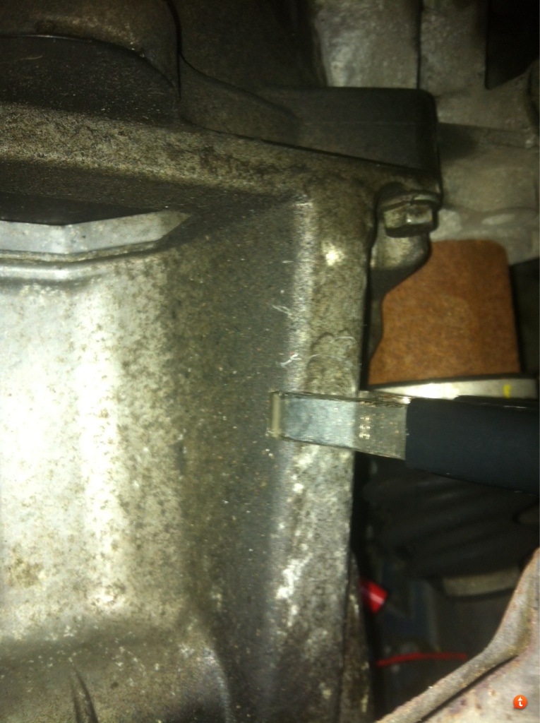

I can't find this starter cable, would anyone happen to have a picture of it from beneath the car? I'm ready to pull my hair out!

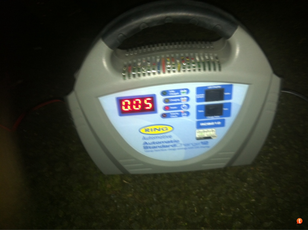

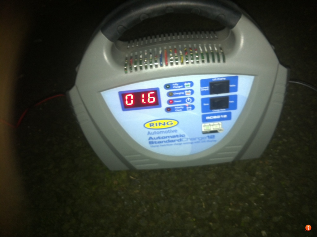

I've connected it to the bolt under that little plastic flap, 0.3-0.4 amps showing...still remote not working

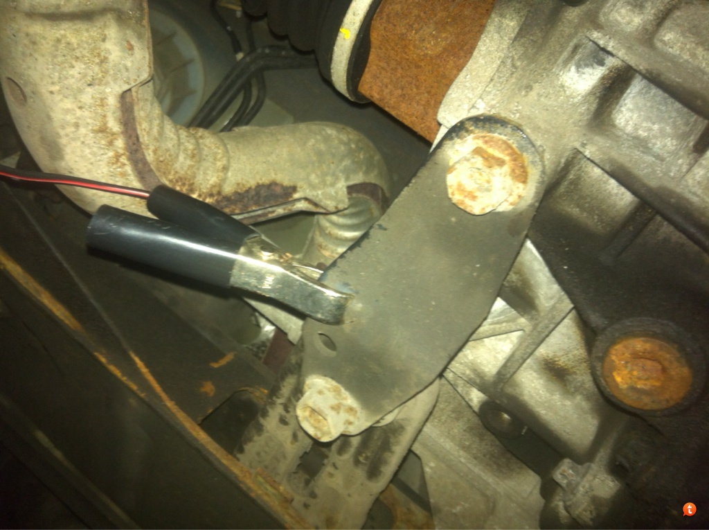

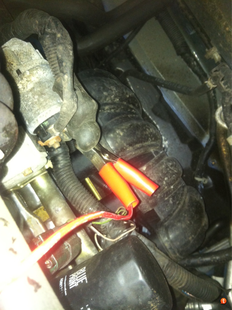

I'll show you what I've done
Positive connected like so...

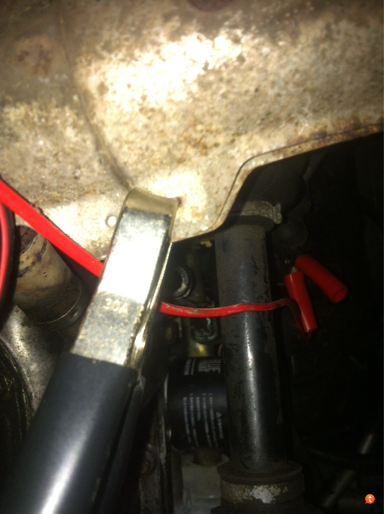

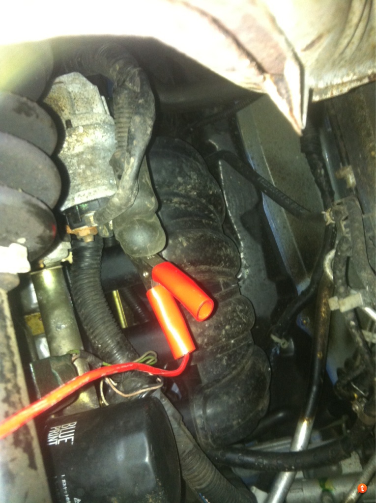

Negative connected...

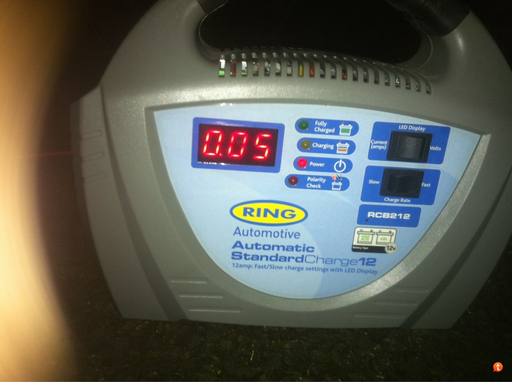

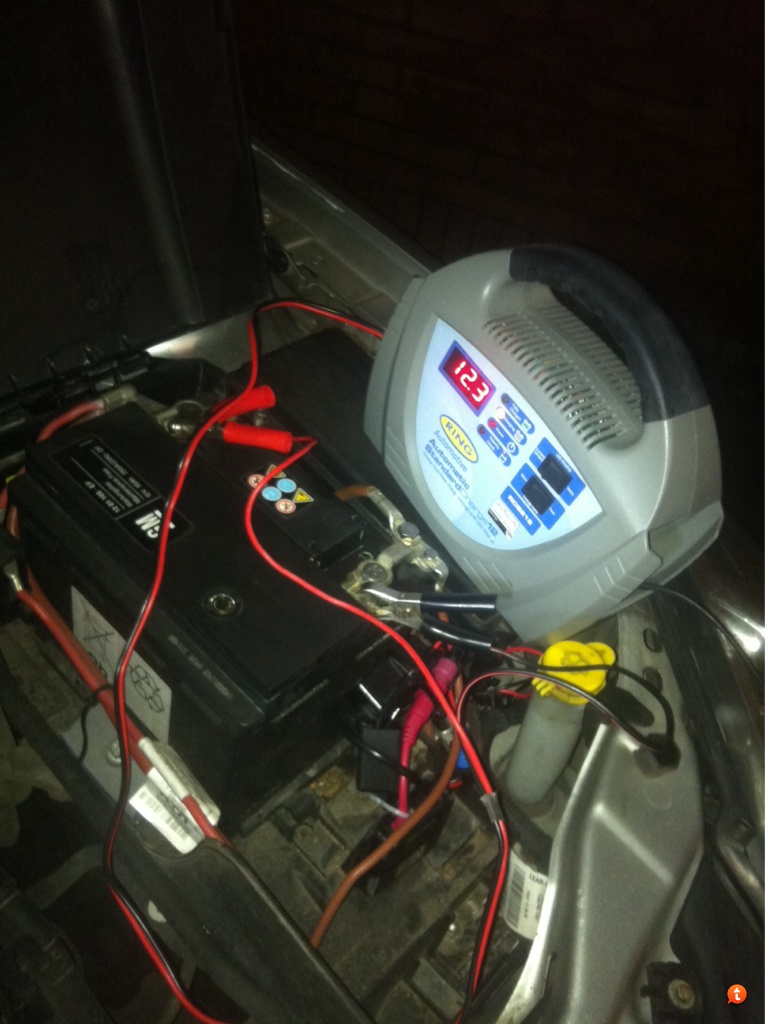

And the display of amps...
And getting nothing :(
praps k12,s are wired different to k11,s then mate ?
the fat lead to the starter on ours are full-time 12v live

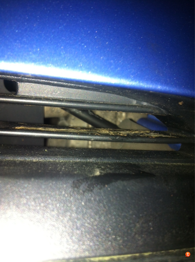

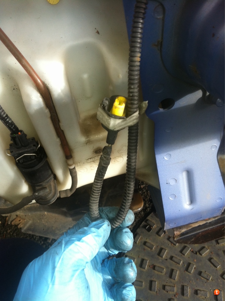

That looks like it could be the bonnet release cable, but I've no chance of even getting a pair of pliers on that to try to pull it
It isn't a booster charger, it is more of a trickle charger I think?

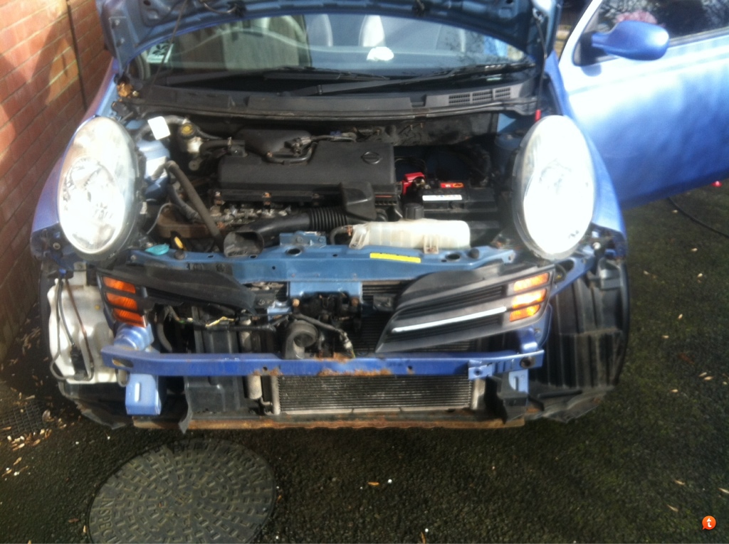

The only thing I can't think to do is break the driver side indicator grill to try to pull the bonnet release cable, the cable isn't a bare cable though, would that work to release the catch?

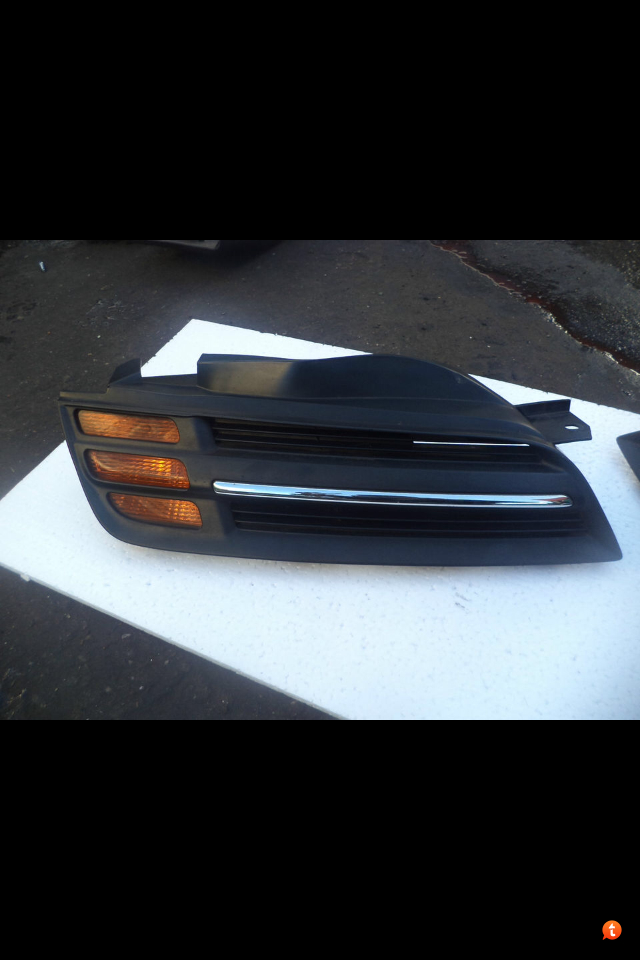

That's how the grille looks so it's definitely bolted beneath the bonnet, would hate to break it and still not be able to open the bonnet :(
even a trickle charger should show a high amperage if you short the 2 wires tho eh, i would try it on another battery

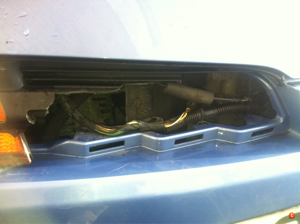

Got my hand around the bonnet release cable behind the indicator grill and gave it a good tug...would not pop open.

Brute force on the bonnet release cable has destroyed the indicator grill and the bonnet still won't release.
