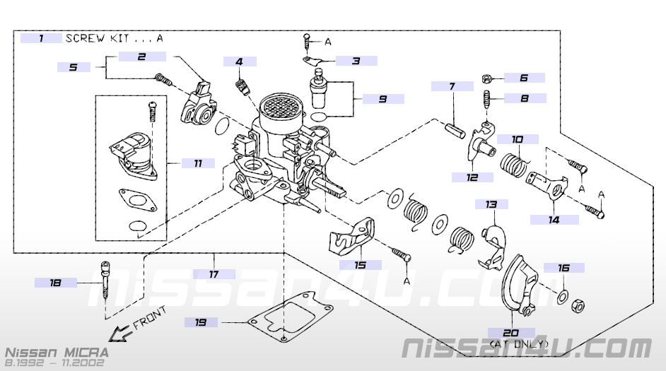

Alright. Is it possible to grease these parts with a silicone spray for example? Or I shouldnt do that. Also, I checked for any cracked hoses that go to the throttle body, but 2 hoses have water in them, and the 3rd one (going from the throttle body to the charcoal canister) was a bit cracked so I cut it and re installed it but nothing really changed. Are there any vacuum hoses that go to the inlet manifold itself that i should check?
