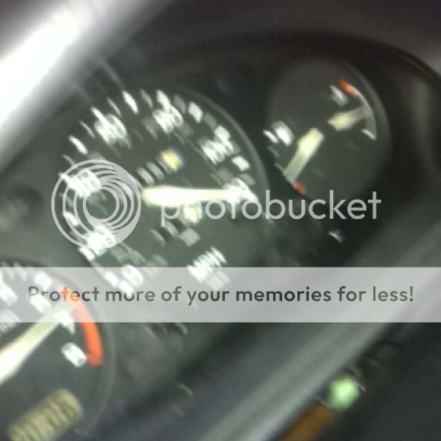

this was 8k with tape over the dizzy disc
and 8.5k on lpg (ie, no petrol injectors to cut)
