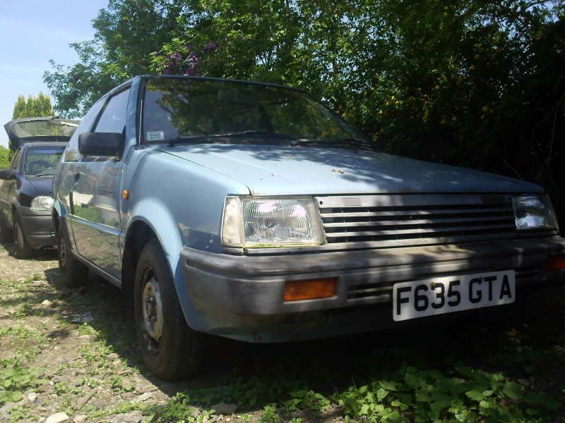

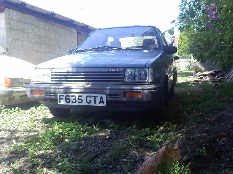

Here is my new project car. Its a project for daily driving that i can muck around with without spending any dollar.
K10 micra ls lowest of the low prefacelift spec.
It was free and is pretty tidy with only 66600 miles on the clock.

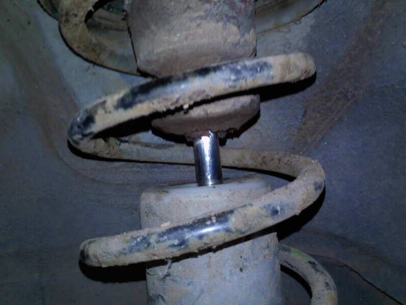

Plans are to mot it next week. Cut the springs heavily, so its on the bump stops. Fit some banded steels, need to make some first, i need some laser cut strips of steel 3inch wide if anyone knows who can do it.

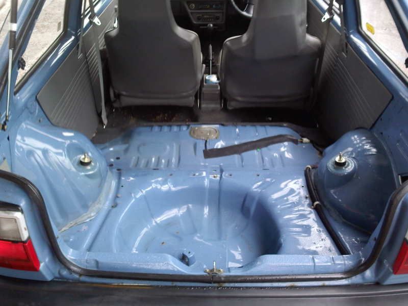

Also got buckets to go in and iam gonna strip it out as per norm

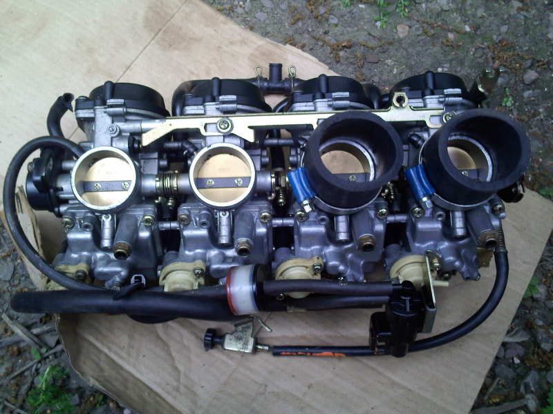

Gsxr 750 carbs

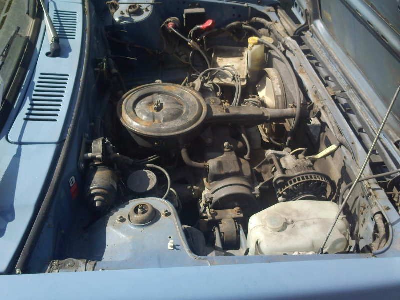

Cg13de engine (at the breakers< just need to pay and collect)
Cg13 engine conversion kit including 3.25kg cg10de flywheel (payed for just awaiting delivery)
12 gallon ally tank (would prefer a 4 gallon tank though)
I know i promised myself that i wouldnt do an engine conversion on this car but its too good to miss. 100hp in 700kgs is gonna be cool fun as long as i can make it handle lol

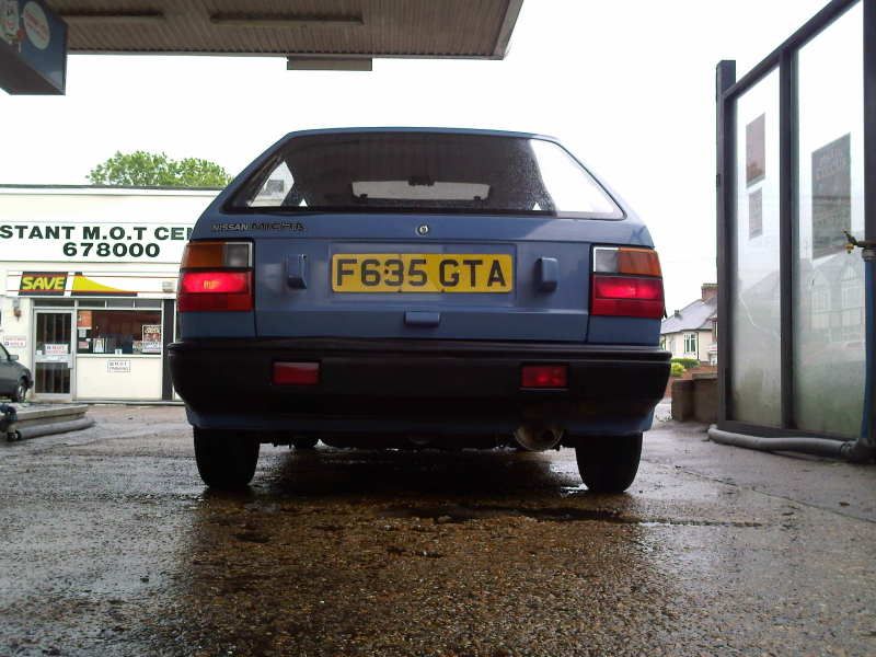

Mot was today, i have one patch to weld and then itll be on the road, retest is booked for next saturday.

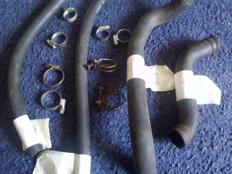

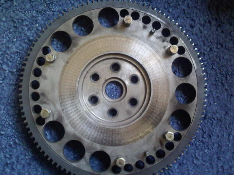

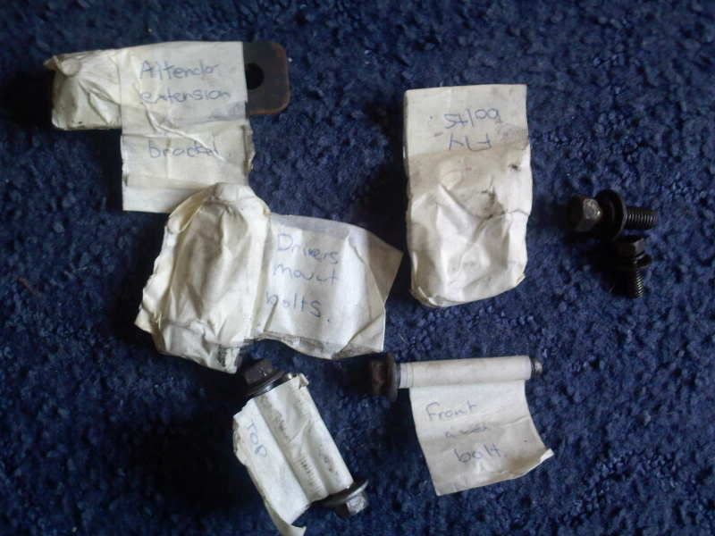

Yesterday i took delivery of a nice box of bits from mr superls.
Basically everything i need for the cg conversion apart from the engine and bike carbs.
Pics.
Bolts
Hoses
Flywheel

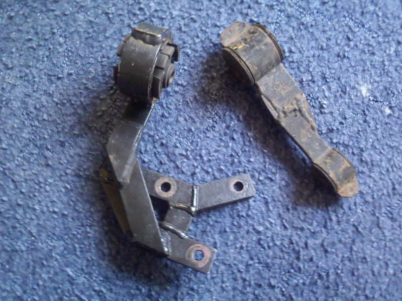

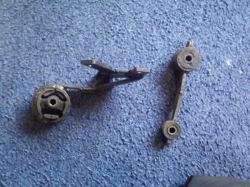

Engine mounts

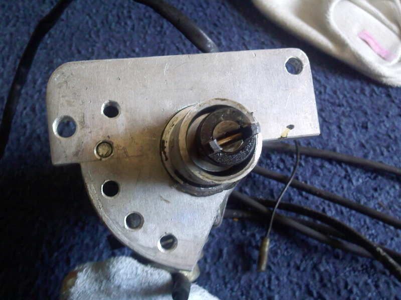

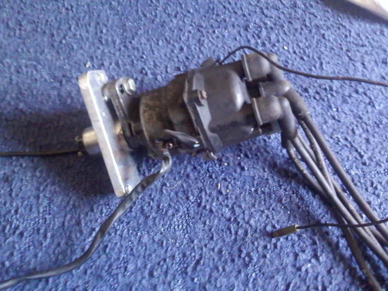

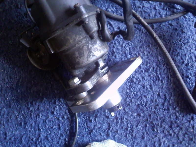

Ma10 dizzy modded for cg
Thankyou please
loving the flywheel mate, im after one of those myself, Loving the idea of bike carbs aswell (Y) if only i knew how to tune em
Superls made the flywheel. Its a cg10 16v flywheels so that it fits withing the small casing gearbox and also matches the cg13 6 bolt cranks :)
Iam sure Scott would do you a good deal on a flywheel.

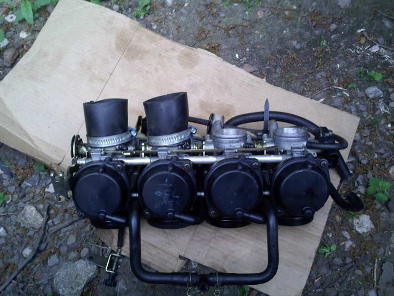

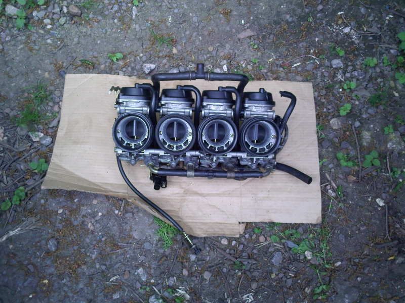

Iam no expert when it comes to the carbs but iam sure i can get it too run well enough to get me too the rolling road. I have been warned that it will run pretty weak. We will have too wait and see. I have some gsxr750 carb s too try out, but need an engine before i can start fabbing a manifold.
Cheers
Kev
cheers for that mate,
im currently eyeing up a set of fireblade carbs for mine and trying to get as much advice as possible

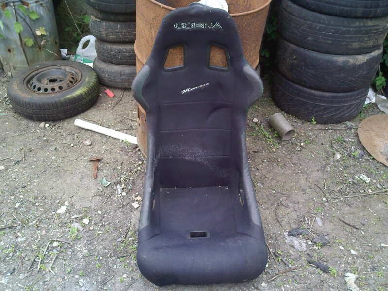

Pics of bits i have for the car.

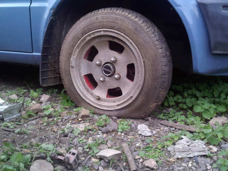

Cobra bucket, i have a pair and the both need a clean
And i tried these on as a temp fit until the bandies are done
More tomorrow :)
:D they do actually look pretty awesome :D
they are only 12 x 5j and they are mini fitment. the offset appears fairly decent though. not quite enough stud is showing so i may get the wheels redrilled slightly.
kev

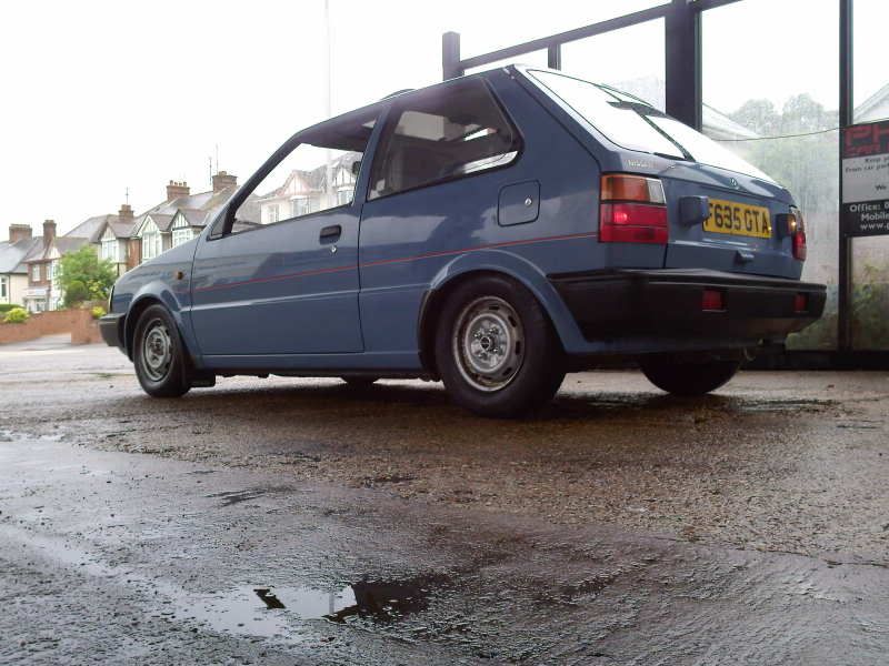

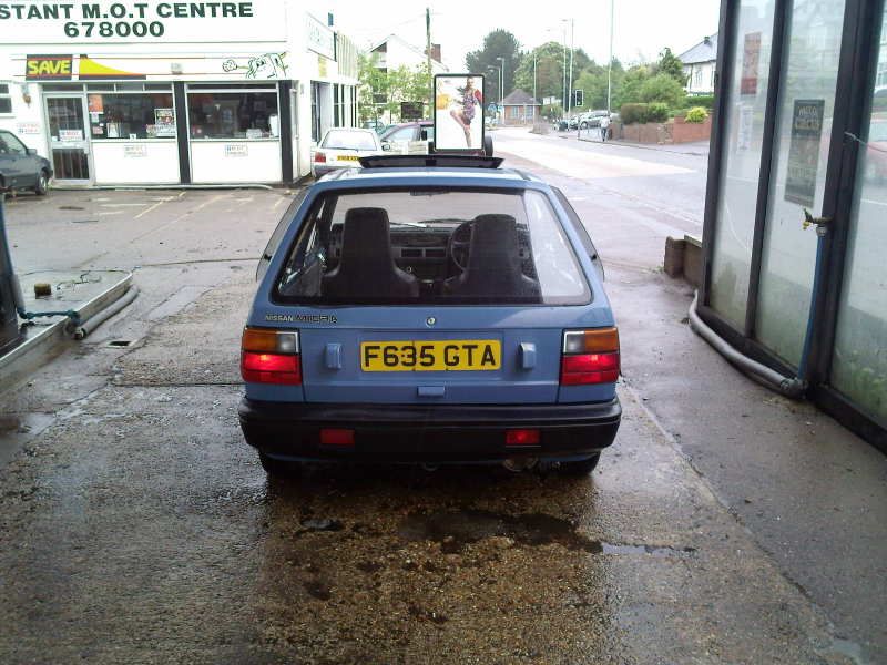

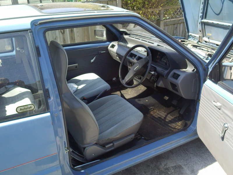

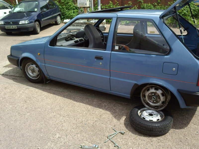

Freshly cleaned, polished, partially stripped and slightly lowered. :D
Also fitted an s13 steering wheel and also found a passenger side mirror delete panel. Ill get pics of those tomorrow.
Kev
Kev

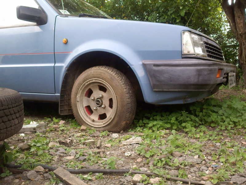

My mates runa car wash which happened to be at my mot centre so i used all there stuff, ill find out what its called but i believe its called durosol. Its possible to get plastics back to black by using a heat gun. Have a look on youtube, try heat gun back to black!.
I chopped 3 coils allround and its pretty much perfect. The back is marginally higher though. I didn't remove the springs from the shocks or the shocks from the car

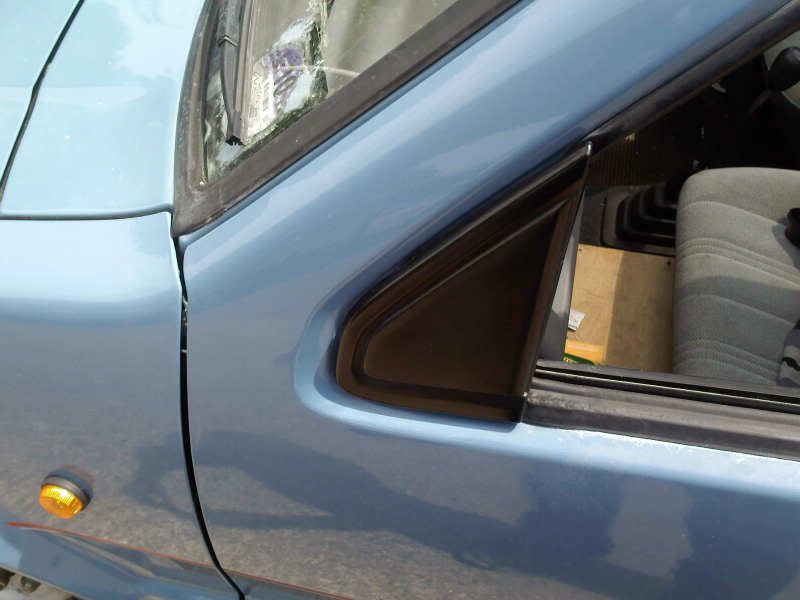

200sx steering wheel
Wing mirrir delete
And facelift wheels 13 x 5 which i will band :)

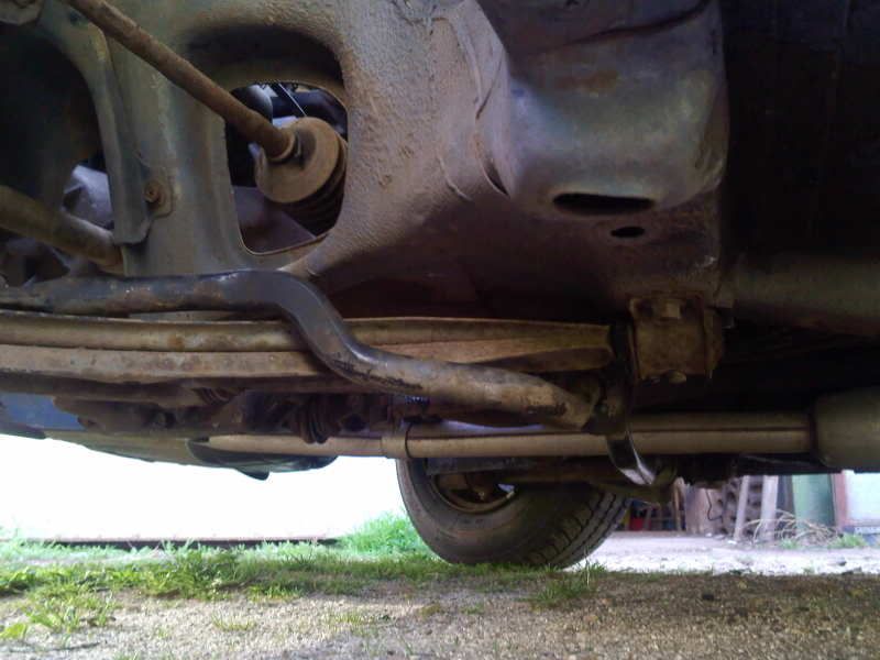

I fitted k11 anti roll bars last night and wow what a difference it has made :) very happy with the results, although I need some new shocks cose mine just bottom out on every bump or corner. Its pretty terrible lol. Iam gonna try and see if i can get mk2 golf coilovers too fit allround. Hopefully try a set on friday.
Also the back end seems to step out on most corners so i think it needs to be softer on the rear, stiffer on the front, lots more camber on the rear and better tyres allround.
Could also do with a quicker ratio rack as well, so i think iam going to be getting k11 hubs, brakes, lower arms ect and midly modding the steering arms for quicker steering.
Next mods will be to add a rev counter and fit some better seats and also sort out decent shocks and springs.
Kev

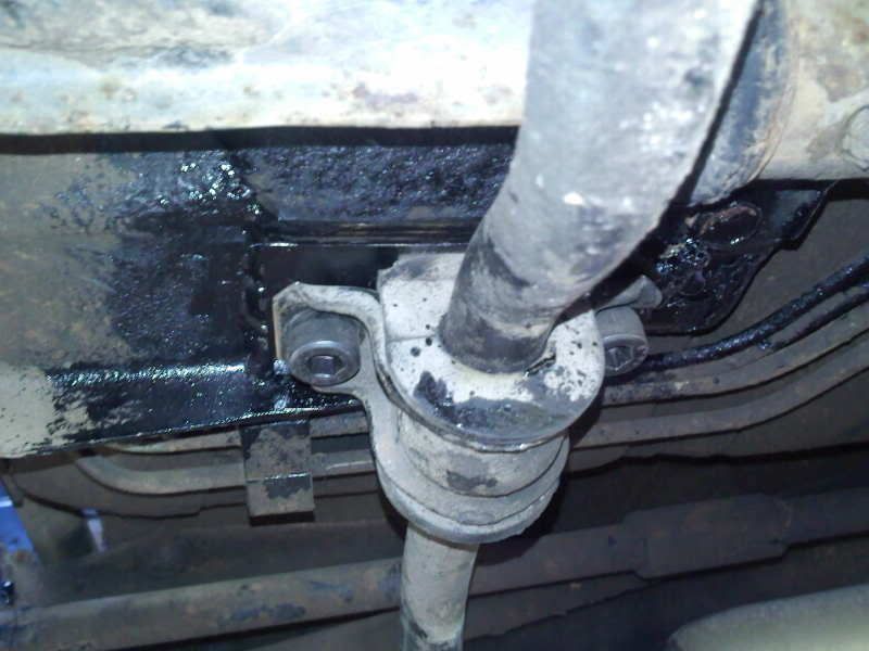

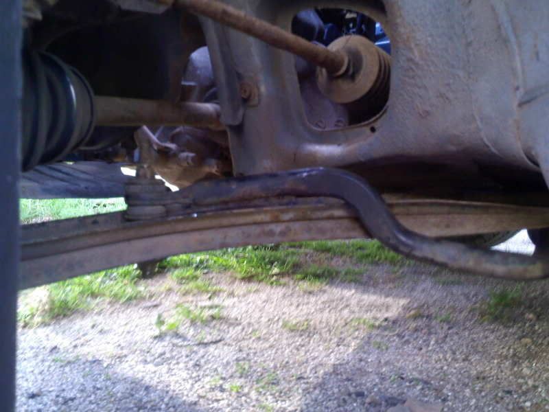

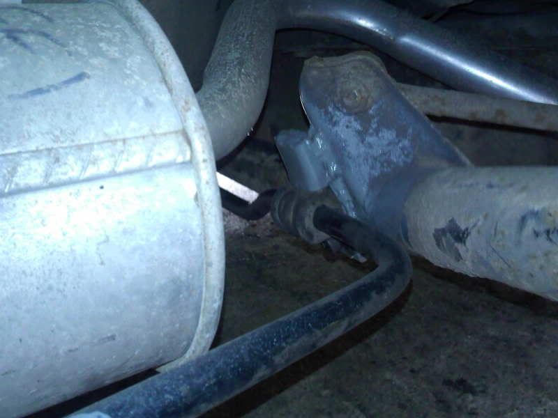

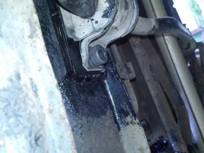

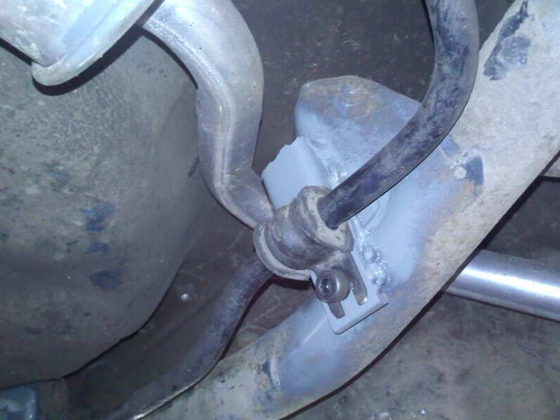

Small amount of modding. I will get you some pics tonight if i get chance.

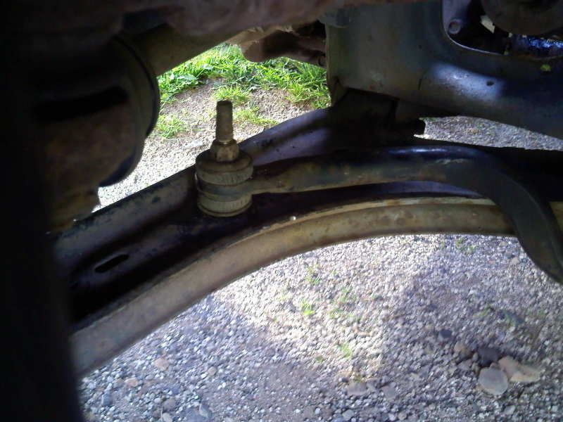

You have to drill the lower arms and make up some plates with tapped threads. These plates are welded to the floor and then the arb bushes and brackets bolt upto there.
I will be swapping the lower arms for k11 soon though.

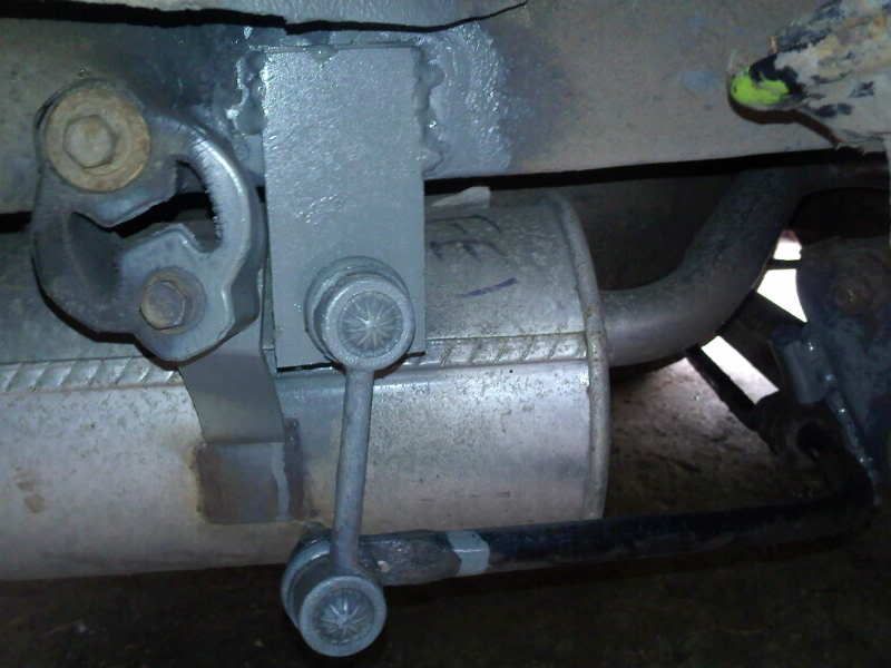

The rear bar involves drilling two holes for the droplinks and then another two threaded plates that weld too the axle for the arb too bolt down to.

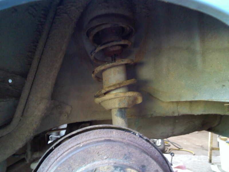

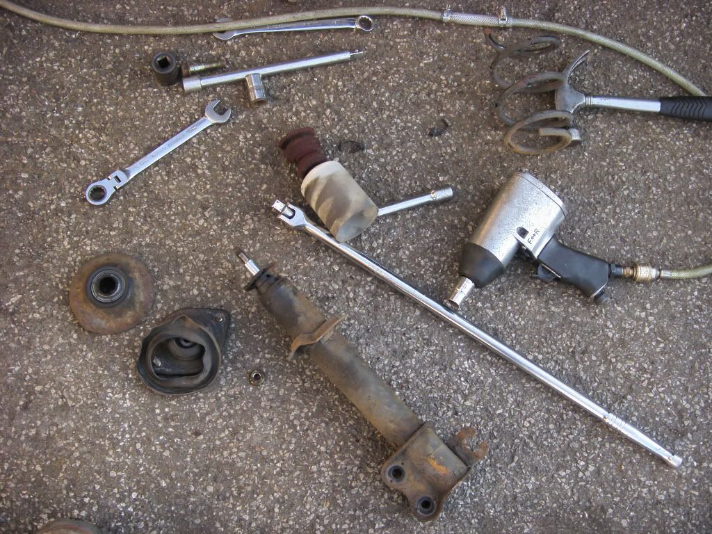

Right i managed to get my hands on some golf coilies to take some measurements from.
I measured the length of them in full bump at theyre lowest setting, when they hit the beginning of the bump stop and they are 10mm shorter than the standard ones in full bump. They are also plenty long enough. The top thread that goes through the top mount is 14mm on the golfs and 10mm on the micras, so i will need new front topmounts. The bottom bracket is 6mm wider so all i need is 3mm packing piece either side. And i need to redrill a hole on each side.
The rears apparently go straight on :)
Need some golf coilies now

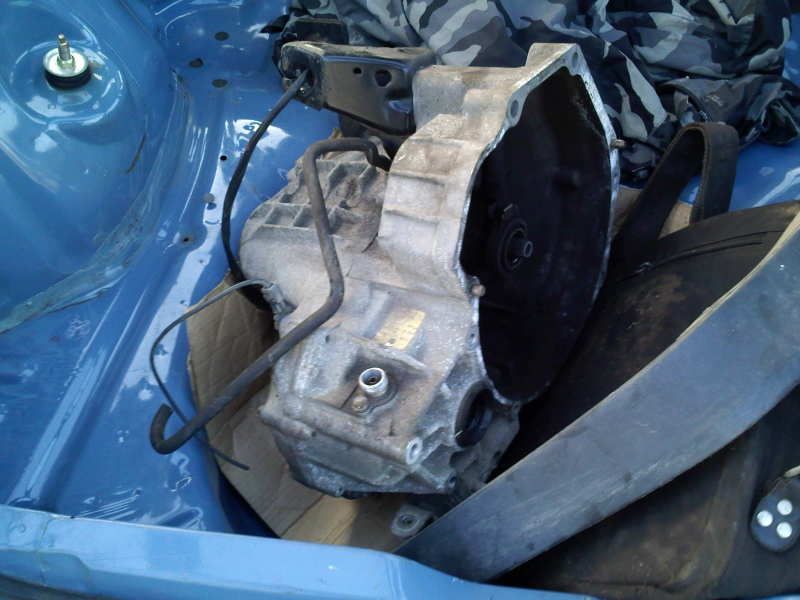

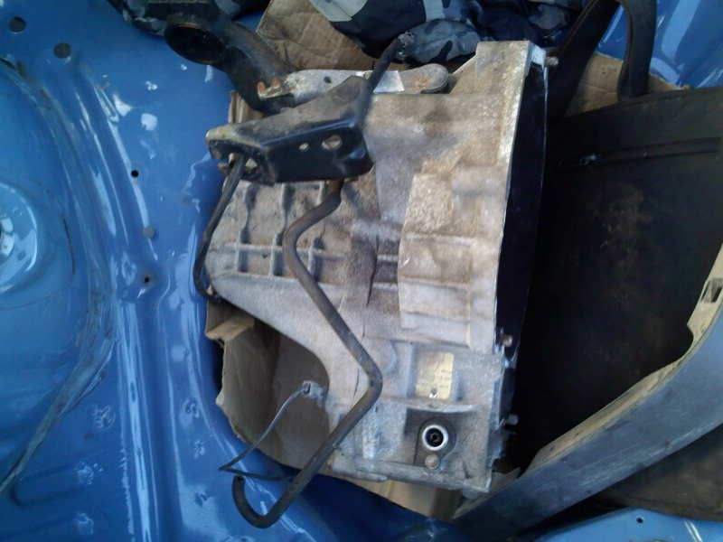

Got a 5 speed last night. Its a 1000cc 16v k11 box (i hope) but not sure how too determine if its the correct one. Ill do a comparison tonight after work.

I really dont mind knocking up some tapped plates for people if they want to do the conversion them selves. The rears attach slightly different and i modded the bush clamps but ill get pics and it maybe easier to use clamps from another car. Ill get some pics up later.
Just having the front bar on alone makes a huge improvement to the handling.
Kev

Nice one :) any idea of a price yet? Are they just plates that have been drilled and tapped in effect? Did u just weld them onto the floor?
The fronts are literally just tapped plates, which anyone could make up and any mechanic could weld them on very easily.
the rears are a little more work. 2 x droplik plates and two times plate for the arb bush bracket. the brackets on the back hook in and have one bolt (see my pics below), its is possible to swap to mx5 rear brackets or anything similar size down the scrappy, but i didnt bother. also i mounted the bar on the back of the axle instead of the front, i did this because it gives me alot more room to get the angles how i want. i think it would be very tight with my rideheight otherwise.
If you just wanted the front bar on which makes a massive improvement by itself, i could do those plates for like 12.50 delivered, depending on if i have the material lying about.
or you could get anyone to knock some up who has a tap and die set.
it is very simple once you get the bar up to the car
rear anti roll bar
Ignore my rubbish welding, i just cannot get on with my dads mig :(
The anti rollbar should be fixed to the front of the axle, but it was a hell of a lot easier for me too mount it off of thye back. wont make much difference because its still will work in the same fashion. It also meant that i could mount it all too take into account my ride height. The plates all need a tidy up and some seam sealer. But the arbs make a massive difference, this car actually drifts round roundabouts lol. The back starts too slide and you can just keep your foot planted and aim in the direction you want. Its is wearing 145 80 12 remould spec knobblies on the rear that arent matching. The brand new 145 80 12 runways on the front are mint in the dry, not a hint of understeer, not driven it fast in the wet.
