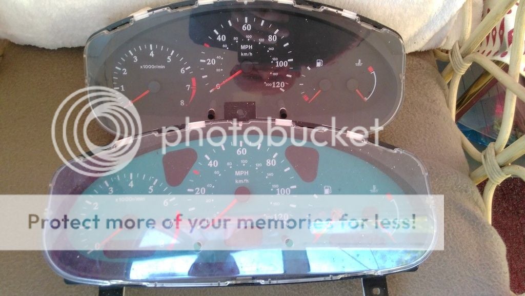

Hi mate, no i bought just a rev counter. Fits seperateDo you mean one of these (?) if it is, they just plug in and play.
Cheers mate! Rev counter has arrived today so will be fitting on weekend. Will post when its done. Cheers for the helpAh a seperate one. There is a blue or light blue wire behind the gauge cluster if im right. On some micra's the rpm wire isnt there. Then you need to get it from the ecu or the distributor.
Fitting a cluster with a rev counter is the easiest because they just bolt in if you have the rev wire that it.
Hi mate, fitted the rev counter and it works fine however it does not light up.... do u know what wire is for ilumination in the instrument cluster? CheersAh a seperate one. There is a blue or light blue wire behind the gauge cluster if im right. On some micra's the rpm wire isnt there. Then you need to get it from the ecu or the distributor.
Okay mate cheers, will try itBehind the stereo its red blue if i remember it correctly. Dont know if this is the same behind the cluster.
Will doReal easy to measure btw. Just switch the lights on and off and see if it changes.
